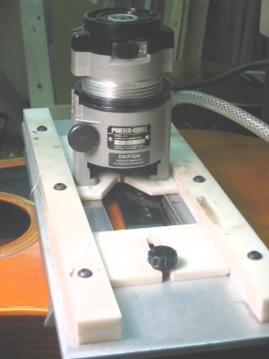

Pc 7310 for me Hesh, but dunno if the quality is that much lesser than the 310, i did not route binding channels with it yet but it sure makes me feel better than my dremel!

The 310 is the finest lam trimmer you can buy-usually for $159.95 plus shipping-many vendors. Get some lucite,center punch the mounting hole pattern into a permanent template and make any size base you desire.(again, that Jasper deal-made some special bases with it) Also, google Pat Warner-he'll make whatever you want and his work is the best. I say, go ahead, steal my 3 full size routers-just leave my 310 alone!

I don't do much building anymore, so binding slots are not a common use
for my laminate trimmer. My 310 is more or less permanantly installed on
my saddle routing jig, for which the power and steady bearings give me a
cleaner cut that any other trimmer I've tried.

Another echo here. The 310 has no equal. I also have the 7310, and the thumb screw adjustment is so sloppy as to be frustrating. It's guess work, at best.
The 7310 does have more power than the 310, though, so I stuck that one in my binding jig, and am perfectly happy with it there(no need to get too fussy with the height when it comes to bindings).

Like Mario, my 7310 sits in the binding machine, the 310 does about
everything else. The B&D is getting lonely on the shelf. Nothing wrong with
its motor and bearings, and it ejects bits better than the PC's, but the base
sucks and it has a higher center of gravity which makes it a bit harder to
handle.

I have both 7310 nd 310. The 310 is super router but truth be known I pick up the 7310 for more quick jobs than the 310 and if hand routing binding channels (I don't do that much any more) I like the 7310 because it fits my hand well. If I am doing any deeper hardwood routing I use the 310
